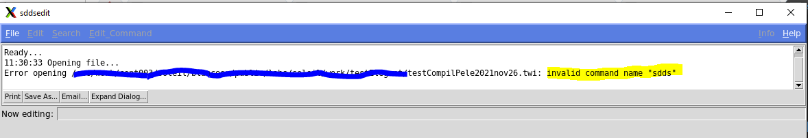

I see it in oag/apps/lib/x86_64/ but, when I tried to test it launching sddsedit and opening a file it seems to be missing something, there is a message saying 'Invalid command name "sdds"' which I think is related to the missing library.

To manually install it, you would need to copy the libtclSDDS.so and pkgIndex.tcl files to the lib/sdds/ directory where your tcl packages are. You can find the location by running:
tclsh
puts $tcl_pkgPath
tclsh
puts $tcl_pkgPath

Re: libtclSDDS.so not in sources
Try setting the TCLLIBPATH environment variable to /home/mypathtoElegantSources/sdds
And place the pkgIndex.tcl and libtclSDDS.so into that directory.

Thank you very much dear Soliday,
now it works !
I got initially confused by the pkgIndex.tcl file inside Tktable, but, the one that works is the one compiled in oag/apps/src/tcltkinterp/extensions/sdds/.
Thank you again,
o
now it works !
Thank you again,
