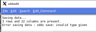

when using sddsedit to open some file and 'save as' test.mmap (momentum aperture) file I see that it is corrupted.
The sddsedit application reports : Error saving data : sdds save : invalid type given.
What could this error mean ?
The new sdds file is saved but it is not possible to inspect it.
