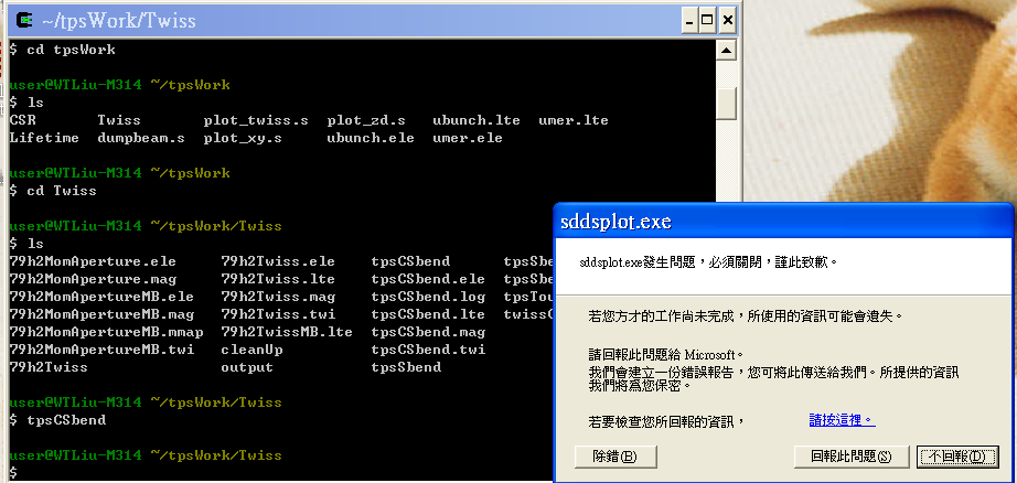

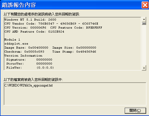

Dear Michael,
I installed the latest version of elegant and SDDS ToolKit to a WinXP computer which I took over from other colleague. After the installation was complete, I copied all old data files to the new PC and did a test run. I just did a simple run to get the Twiss functions of a storage ring. The elegant command worked as it used to be on my old PC. But I got an error message when I ran the script to generate plots of Twiss function. The screenshots of error message are shown in the following pictures. I can execute the sddsplot command in the terminal mode but not with the sample script I obtained from elegant example files. If I modified the script file as following, then I got the plot of Twiss function as I used to on my old PC. The 'tcl-brlapi: tcl bindings' package was installed in CYGWIN. The tclsh.exe is in c:\cygwin\bin.
Is it critical to include those lines and keywords which I commented out in the script?
Ping

I just installed the Tcl from Cygwin and I can see the problem now. The problem is related to the way sddsplot calls mpl_motif which actually displays the plot. The program crashes on the popen call for some reason. I am looking into the problem but Google has 14 thousand hits for "cygwin popen crash." What I would recommend for now is to install Tcl from http://www.activestate.com/Products/act ... ndex.mhtml
I use the free ActiveTcl 8.4.19. Just put this in your path before Cygwin's version of tclsh. I do not see the problem when I use this version of Tcl.
