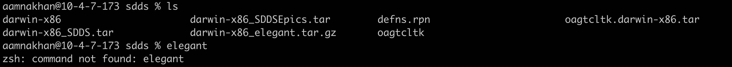

I’m trying to install elegant on macbook pro (macOS BIg Sur ver. 11.1). I downloaded the files at home/sdds dir. and followed all the installation instructions, but still I can execute elegant using ./elegant in the sdds folder only. Elegant was working fine on my old system, and I checked most of the suggestions on the forum. I suspect like most of the cases there is something wrong with the path. I would really appreciate any help. Thanks!

I've already setup environment variables in ~/.profile still it shows command not found.
						Re: Installation on mac OS
You are in a zsh shell environment. So you would probably have to edit your .zshrc file and put the path commands in there.
Thank you my bad. Unconsciously I tried to edit the bashrc file instead of zashrc
