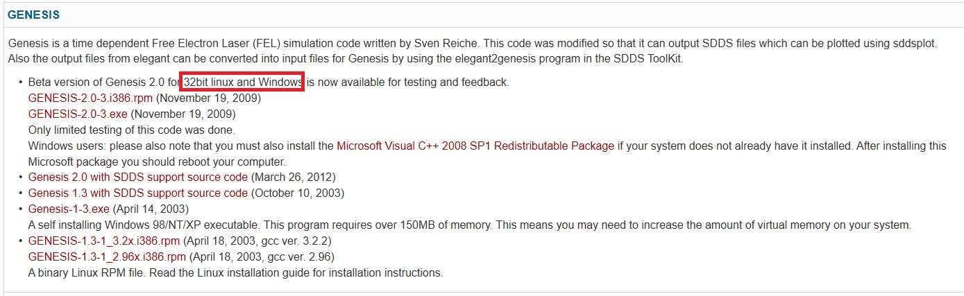

Thank you for your reply. I've seen the GENESIS-2.0-3.exe file on the software download
page, but I'm not sure of its compatibility for 64-bit Windows.
Would you please tell me how to run it parallel in windows and which mpi enviroment
is needed? Is MS MPI suitable for genesis?

Post by soliday » 20 Sep 2019, 08:44
The MPI version was never built for Windows so it is not included in the GENESIS-2.0-3.exe executable. When I get some free time, I will look into fixing the build. I need to convert it from using Intel Fortran to mingw gfortran. I am not sure if Microsoft MPI with work with this though.
