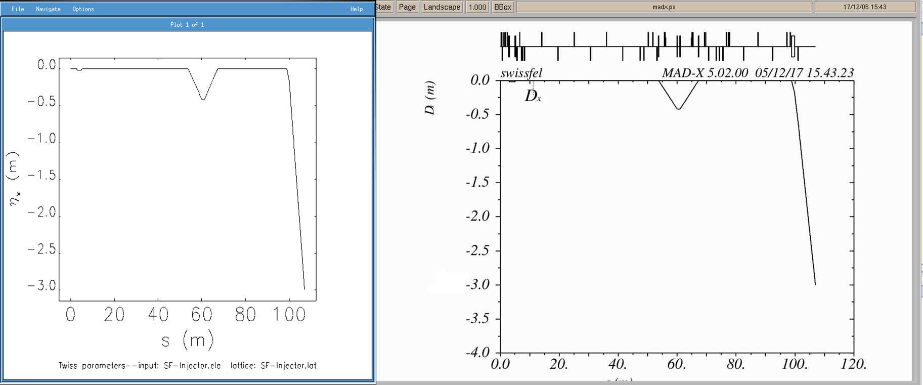

we are trying to run Elegant. We generated a lattice file of MAD-X and Elegant. We plot the dispersion with the two codes and we obtain similar result, but when we try to plot R56 we have a discrepancy of a factor 2.
We tried with two versions of Elegant (both of them of 2017) and with different lattices.
I upload the relevant Elegant files, the plots of the dispersion and R56 for MAD-X and Elegant.

We have also a tool to compute (and we measured in the machine) R56, and this is fitting with the MAD-X expectations.
It is possible that we are doing something really wrong doing the computation of R56...
