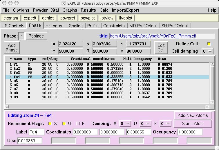

Go to the Phase panel
(screen image)
and press the "Add Phase" button. To input the information from the CIF,
click on the "PowderCell .CEL file" menu button to bring up a menu of choices
(screen image)
and select "Crystallographic Information File (CIF)"
which brings up a window where the file YBaFeO_Pmmm.cif can be selected.
(screen image);
click on "Open" after the file is
selected.

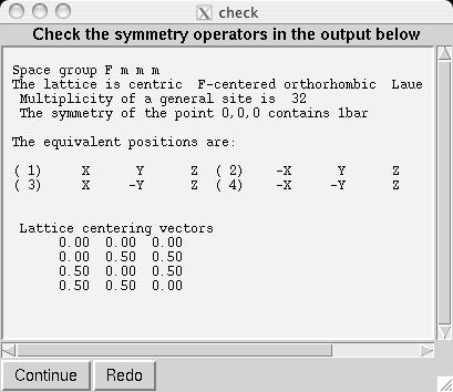

Click on "Continue" on the add new phase
(screen image)
and on the Check symmetry windows
(screen image)
and then "Add Atoms" on the Adding atoms... window
(screen image)
and the phase has been added, just like that.
Finally, make sure the "Refine Cell" option is not selected,
(screen image)
so that the unit cell parameters
will be refined until later, after the background and scale factor
are first brought into the right range.

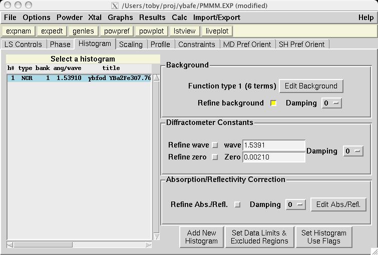

Input Diffraction Data
The second step in almost every GSAS refinement is to input diffraction data
(or select data parameters in a simulation). This is done from the Histogram
panel
(screen image).
Click on the "Add New Histogram" button
which brings up the add new histogram window
(screen image).
Press the Select file to select the appropriate GSAS data file
in the Open window
(screen image);
press the open button
and the file names for the both the data file and the instrument parameter files
are loaded (you might see messages about file conversions if the download
process has stripped non-printing characters needed from the files.). Finally,
change the data range to utilize a maximum two-theta of 152 degrees
on the add new histogram window, which
eliminates the last very wide peak from use in the refinement (the fit
would also progress well were this peak included)
(screen image).
Press "Add" on this window and the
diffraction data are now included in the refinement
Finally, change the background function to type 1 with 6 terms by pressing the
"Edit Background" button (this is the authors' preference -- but other
settings could be selected.)
(screen image).
Finally, confirm that the "Refine background" option is selected so that
the background will be fit
(screen image).

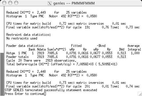

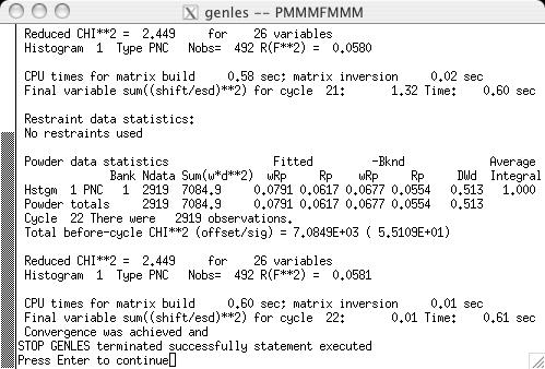

Start Initial Fit of Experimental Parameters
The fit can now be started, by pressing the "powpref"
(screen image)
and "genles" buttons
(screen image).

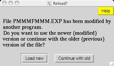

Note that pressing each button starts a program in another
window and then (unless the default settings have been changed) after
each run has been completed, the extra window is closed and the "Load
New" button is pressed on the Reload screen
(screen image).
Note that after the two cycles
of refinement, the chi2 value drops to approximately 44.

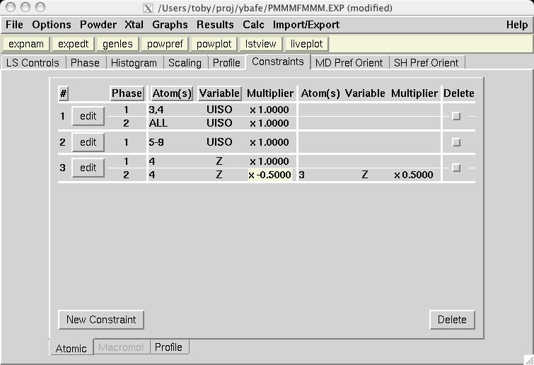

Uiso values for like element
types are grouped together to reduce the number of parameters.

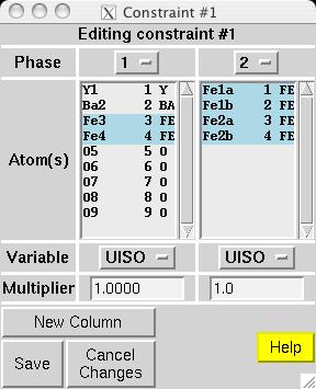

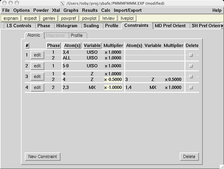

This is done with the Constraints panel
(screen image).
To set up the constraint on the Fe atoms,
Press on the "New Constraints" button, then select them by dragging over
them with the mouse and select UISO in the Variable menu button
(screen image)
and press "Save".
Repeat this with the O atoms,
Press on the "New Constraints" buttton by dragging over those atoms
with the mouse; then select UISO in the Variable menu button
(screen image)
and press "Save".
The Constraints panel will then list the two constraints
(screen image).

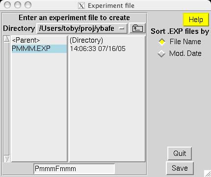

Save work under new name
Before going any further, lets save the project under a new name, so that
it is easy to compare later work to the non-magnetic model, or so that it is
easy to go back to this point to proceed with an alternate magnetic model.
To do this, use the "Save As" option in the EXPGUI "File" menu item.
This opens an experiment file window, where the new name to be used
is specified
(screen image).
The name PmmmFmmm was selected here, since the nuclear structure will be
modeled in space group Pmmm and the magnetic structure in
Fmmm and a new experiment file, named PMMMFMMM.EXP is created.

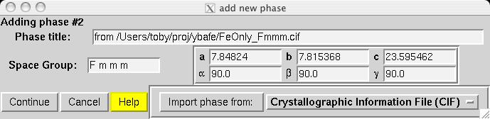

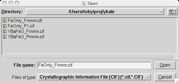

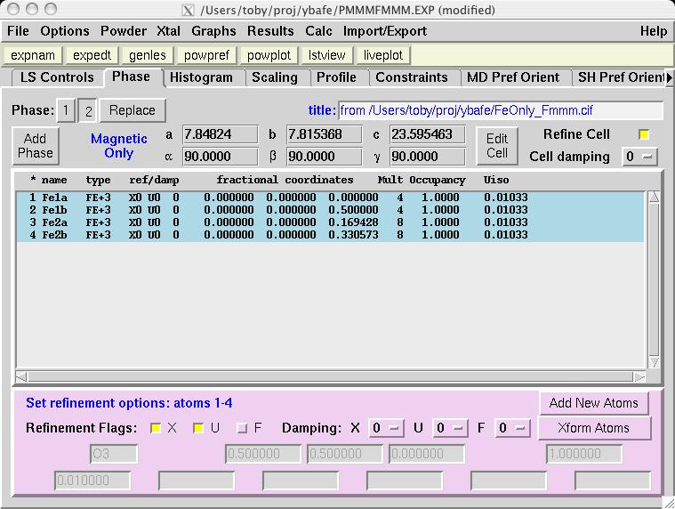

- First, the phase is loaded by clicking on the "Add Phase" button on the
Phase panel. To input the information from the CIF,
FeOnly_Fmmm.cifcan be selected. (screen image); click on "Open" after the file is selected. - In the add new phase window, change the a, b & c parameters to be twice those of the first phase, then click on "Continue" on the add new phase (screen image). Also, press "Continue" on the Check symmetry window (screen image). This causes the Adding atoms... window to be displayed. (screen image). In this window, change the z coordinate for atoms Fe2a and Fe2b based on the z coordinate of the second Fe atom. Also change the Uiso value ot agree with the Uiso values for the atoms in phase 1 (screen image) Finally, press the "Add Atoms" button on this window to add the phase.

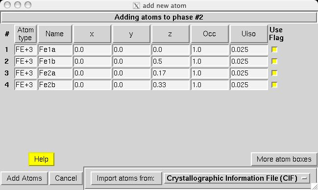

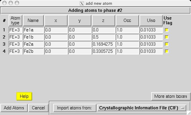

To add a separate magnetic phase, the phase will be added as a standard (nuclear scattering-only) phase using EXPGUI, then EXPEDT is used to change a flag so that it contribributes only as a magnetic scatterer. Also, constraints on atomic, unit cell and profile parameters are needed. Some of these values can be set from EXPGUI, but others must be set from EXPEDT.
The magnetic phase is described using:
| Element | Label | x | y | z | Moment |
| Fe+3 | Fe1a | 0 | 0 | 0 | 3.5 |
| Fe+3 | Fe1b | 0 | 0 | 0.5 | -3.5 |
| Fe+3 | Fe2a | 0 | 0 | z/2 | -3.5 |
| Fe+3 | Fe2b | 0 | 0 | 0.5-z/2 | 3.5 |
As before, to save time, the basic phase information can be read from a CIF,
FeOnly_Fmmm.cif
in file
YBAFEO.zip,
though in this case some editing of the input information will be needed.

Fe1b 0.000000 0.000000 0.500000
No magnetic moment is currently defined
Constraints on the moment are 1 1.00 0 0.00 0 0.00
New moment =-3.50000 0.00000 0.00000 3.500 90.000 180.000
Enter magnetism editing option (<?>,A,C,L,M,S,X) >m 3 -3.5
Fe2a 0.000000 0.000000 0.169428
Enter magnetism editing option (<?>,A,C,L,M,S,X) >m 4 3.5
Fe2b 0.000000 0.000000 0.330573
New moment = 3.50000 0.00000 0.00000 3.500 90.000 0.000
Enter magnetism editing option (<?>,A,C,L,M,S,X) >x

After the EXPEDT window is closed since EXPEDT has changed the experiment file, (unless the Autoload EXP option is set) there is a prompt to load the information from this changed file: press the "Load new" button to continue (screen image).

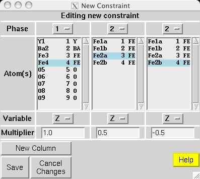

Setup Atomic Constraints
The Fe2a & Fe2b atoms in the magnetic phase should move in concert with the Fe4 atom in the nuclear phase, where the shift on Fe2a will be 50% the shift on Fe4 and the shift on Fe2b will be -50% of the shift on Fe4. This is done on the Constraints menu, by pressing the "New Constraint" button to open the Edit Constraint window. Press the "New Column" button twice to create a second and third constraints subwindow. Select Phase 1, Fe4, variable Z and multiplier 1.0 in one column, Phase 2, Fe2a, variable Z and multiplier 0.5 in another column, and Phase 2, Fe2b, variable Z and multiplier -0.5 in the remainined column (screen image). Then press the "Save" button to enter the new constraint. (Note that multipliers have an arbitrary scale; multipliers of -2,-1,1 would provide equivalent results.)
Likewise, the constraint on the Uiso for the Fe atoms is expanded to include the Fe atoms in the second phase. This is done by clicking on the first "edit" button to amend the first constraint. On the Editing Constraint #1 window, press the "New Column" button, select Phase 2 in the new column, select all atoms; the Variable selection defaults to Uiso and the Multiplier value defaults to 1.0 (screen image). Then press the "Save" button to enter the modified constraint (screen image).

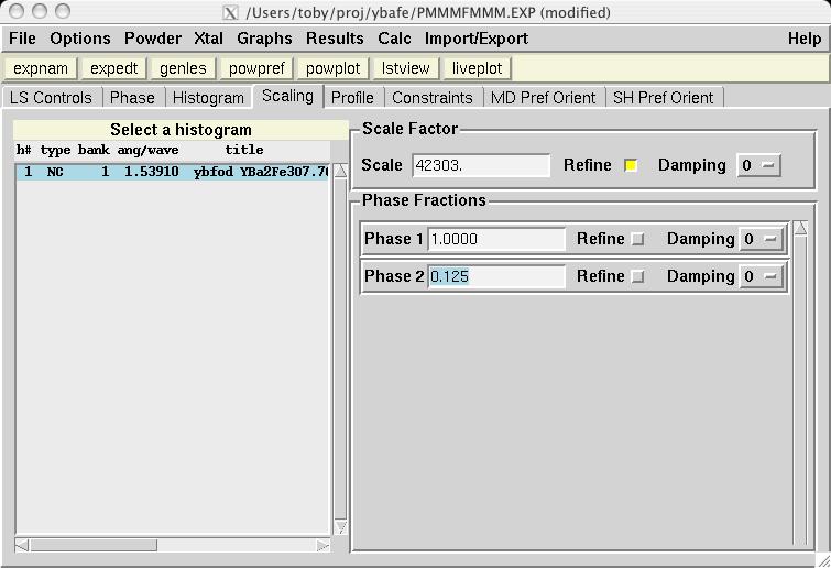

Constrain Phase Fractions
GSAS scale factors are proportional to the number of scatters present in the unit cell. Since the unit cell of the magnetic phase is eight times larger than that of the nuclear phase, the scattering from this phase will be over counted. To prevent this (so that magnetic moments are scaled properly with respect to the nuclear scattering), the phase fraction of the second phase is lowered by the ratio of the unit cell volumes (1/8). This is done by changing the Phase Fraction for Phase 2 on the Scaling panel (screen image). Make sure that the scale factor is refined, but not either of the phase fractions.
Phase 2 Refinement Flags
- Click on the "Refine Cell" checkbutton.
Also, turn on the
X and U flags, so that the z coordinates
of the Fe atoms and the Uiso values will follow the atoms in the
nuclear phase, by highlighting
all atoms and selecting the "X" and "U" checkbuttons
(screen image).
Note that the first two Fe atoms in the magnetic phase will not change position regardless of the X flag, as they are on special positions with no degrees of freedom.
Constraints have been established on the unit cell and the atomic parameters of phase 2. It is important to set the refinement flag and damping values to be the same for constrained parameters. Since unit cell paremeters, Uiso values and Fe4 z are refined in phase 1, the same must be done in phase 2. On the phase panel, select phase 2, noting that EXPGUI now shows that the phase is magnetic-only directly below the phase selection buttons.

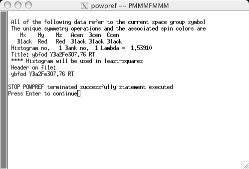

Since a new phase has been added to the refinement, it is necessary to run POWPREF (screen image). and then GENLES (screen image). The fit improves from the previous chi2 value of approximately 21 to a new value of approximately 15, as the low-angle magnetic lines are now computed with more intensity, as can now be seen in LIVEPLOT (screen image).

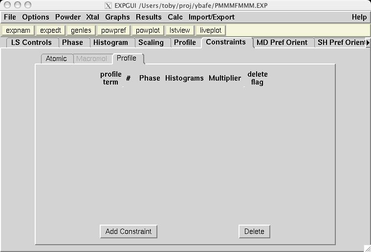

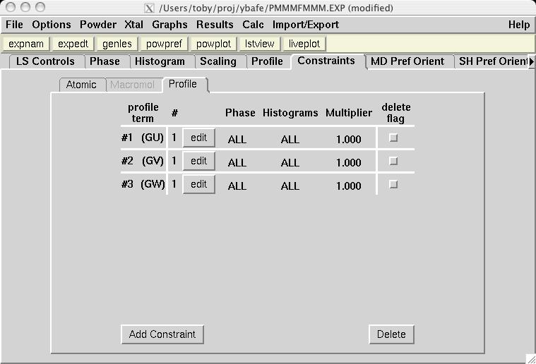

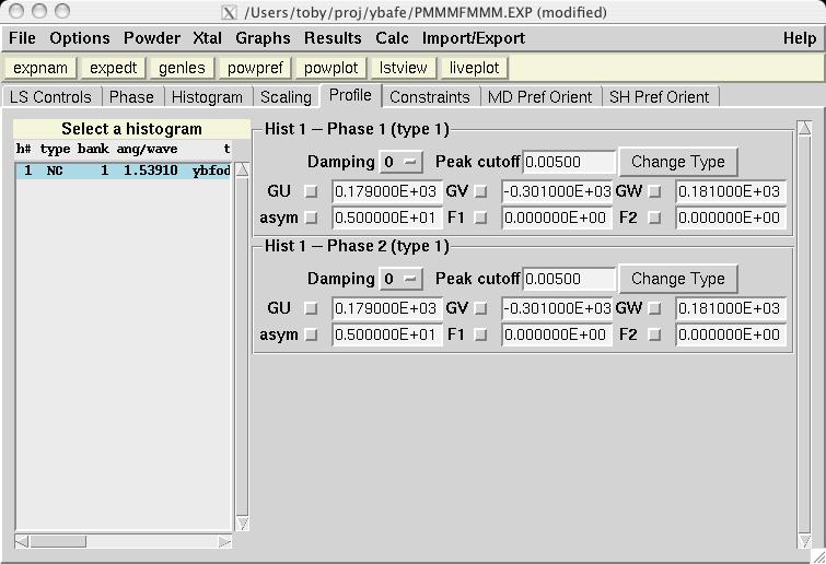

Constrain and Refine Profile Constraints

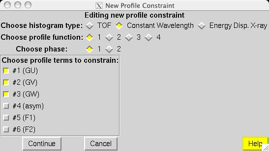

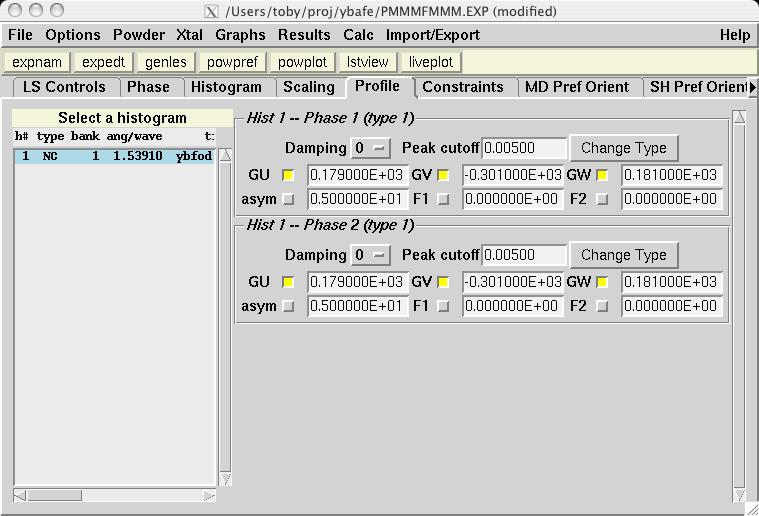

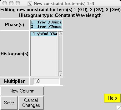

From the previous LIVEPLOT result, it is clear that the profile is a major source of differences between the observed and computed diffraction data. While it is possible to have different ordering ranges for the nuclear and magnetic ordering, in most cases, it is best to have the same parameters, for both the nuclear and magnetic phases.
A quick check of the Profile panel shows that the profile termes are the same for both phases because they are still at their default values, having not been refined. (screen image). To constrain the profile terms to refine to be the same, select the Constraints panel and the click on the lower Profile tab and then press the "Add Constraint" button (screen image). This will open the New Profile Constraint window (screen image). Select GU, GV & GW to be constrained (none of the other terms need to be refined); then press the "Continue" button. In the next window, select both phases in the top part of the window and press the "Save" button (screen image). This generates the constraints, which show up on the Constraint panel (screen image).
Select the check buttons for GU, GV & GW in both phases (screen image) and then start GENLES (screen image). The fit improves from the previous chi2 value of approximately 15 to a new value of approximately 3.4. Running POWPREF and then GENLES again causes chi2 to drop from 3.4 to 2.6 just due to the expansion of the peak shape range from POWPREF. Subsequent refinement cycles improves chi2 slightly, to 2.45 (screen image).
Constrain & Refine Magnetic Moment
In most magnetic refinements, one wishes to refine magnetic moments.
It should be noted that the Fe1a and Fe1b atoms are symmetry related,
as is the case for Fe2a and Fe2b.
One could consider treating the two Fe1 atoms as having
different moments from the two Fe2 atoms, but this makes little
chemical sense, since there is no reason to expect either site to
have an accumulation of off-valence Fe atoms. Further, due to the
pseudo-symmmetry of the cell, there are few reflections that distinguish
the two non-equivalent Fe scatterers. Thus, it is best

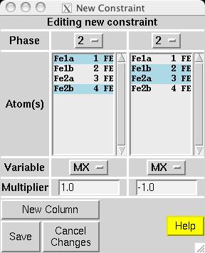

to treat all Fe atoms as having a single magnetic moment. EXPGUI
can be used to set up constraints on the magnetic moments,
by creating a new atom constraint on the Constraints panel, where a
shift multiplier of 1.0 is applied to MX of atoms 1 & 4 in phase 2
and a shift multiplier of -1.0 is applied to MX of atoms 2 & 3 in phase 2
(screen image).
Press the "Save" button and the constraint appears
(screen image).

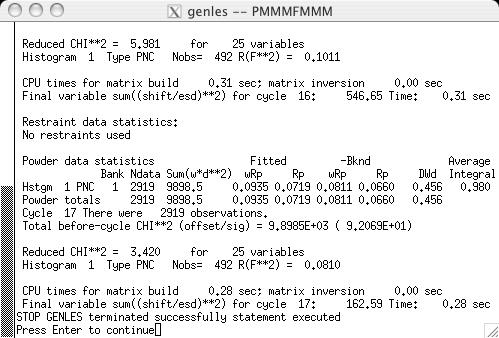

The refinement is then started with GENLES. The magnetic moments shift only slightly (as can be seen from the LSTVIEW output) and the chi2 value drops only slightly (screen image).
