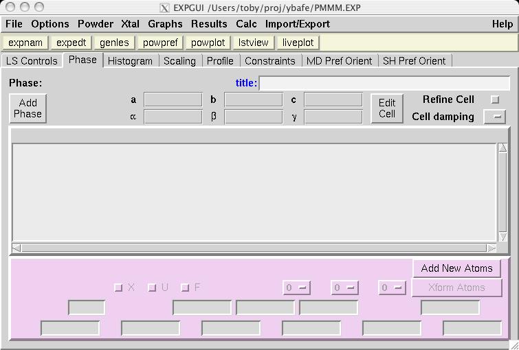

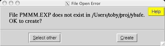

The first step in the refinement is to start a new refinement by creating a
new experiment file. Start EXPGUI and enter a new file name
(screen image)
then click on the "Create" button to then create a new, empty, experiment file
(screen image)
and enter a title.

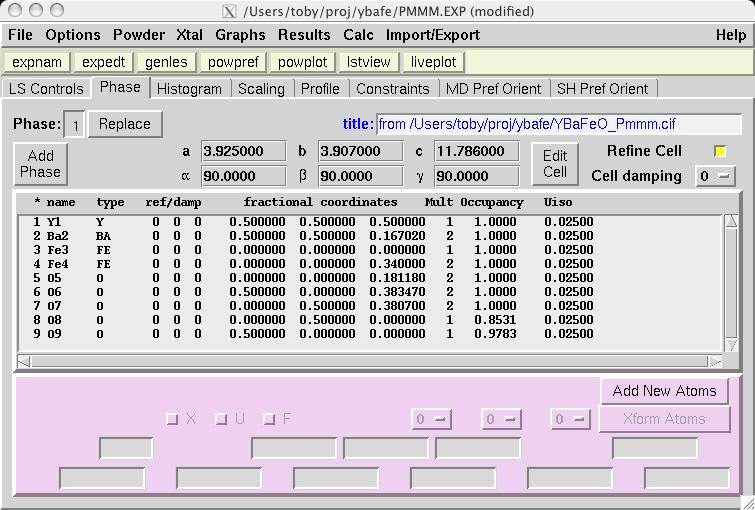

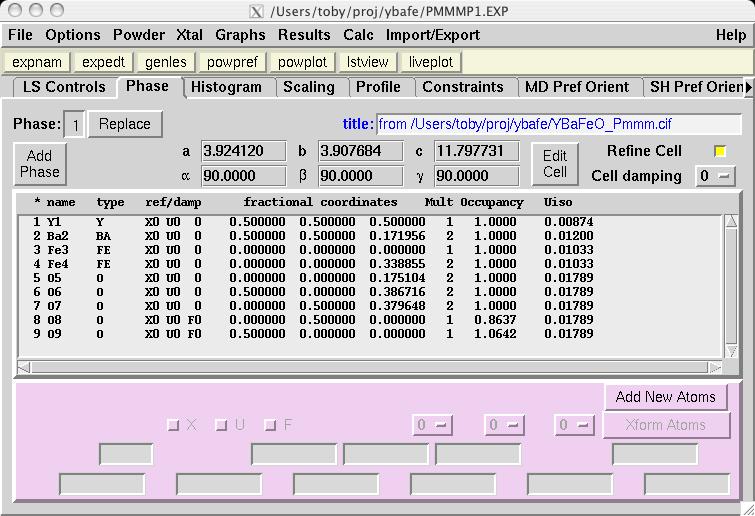

Go to the Phase panel
(screen image)

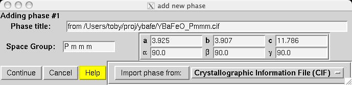

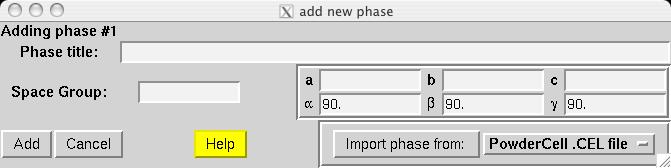

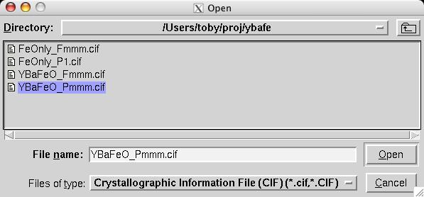

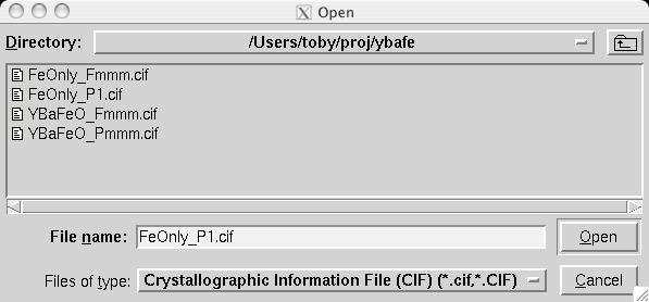

and press the "Add Phase" button. To input the information from the CIF,
click on the "PowderCell .CEL file" menu button to bring up a menu of choices
(screen image)
and select "Crystallographic Information File (CIF)"
which brings up a window where the file YBaFeO_Pmmm.cif can be selected.
(screen image);
click on "Open" after the file is
selected.
Click on "Continue" on the add new phase
(screen image)

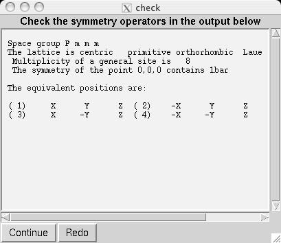

and on the Check symmetry windows
(screen image)
and then "Add Atoms" on the Adding atoms... window
(screen image)
and the phase has been added, just like that.
Finally, make sure the "Refine Cell" option is not selected,
(screen image)
so that the unit cell parameters
will be refined until later, after the background and scale factor
are first brought into the right range.

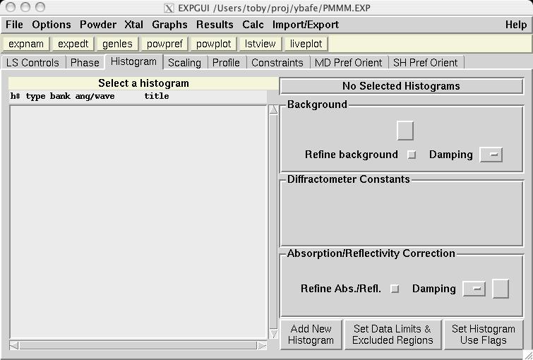

Input Diffraction Data
The second step in almost every GSAS refinement is to input diffraction data
(or select data parameters in a simulation). This is done from the Histogram
panel
(screen image).

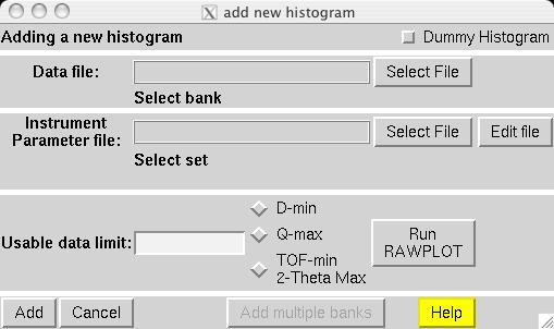

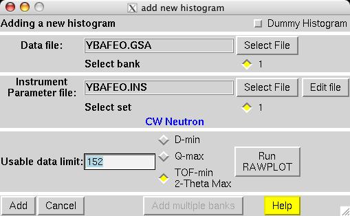

Click on the "Add New Histogram" button
which brings up the add new histogram window
(screen image).

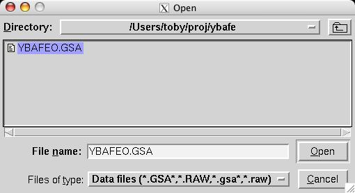

Press the Select file to select the appropriate GSAS data file
in the Open window
(screen image);
press the open button
and the file names for the both the data file and the instrument parameter files
are loaded (you might see messages about file conversions if the download
process has stripped non-printing characters needed from the files.). Finally,
change the data range to utilize a maximum two-theta of 152 degrees
on the add new histogram window, which
eliminates the last very wide peak from use in the refinement (the fit
would also progress well were this peak included)
(screen image).
Press "Add" on this window and the
diffraction data are now included in the refinement

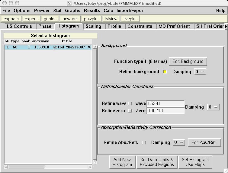

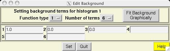

Finally, change the background function to type 1 with 6 terms by pressing the
"Edit Background" button (this is the authors' preference -- but other
settings could be selected.)
(screen image).

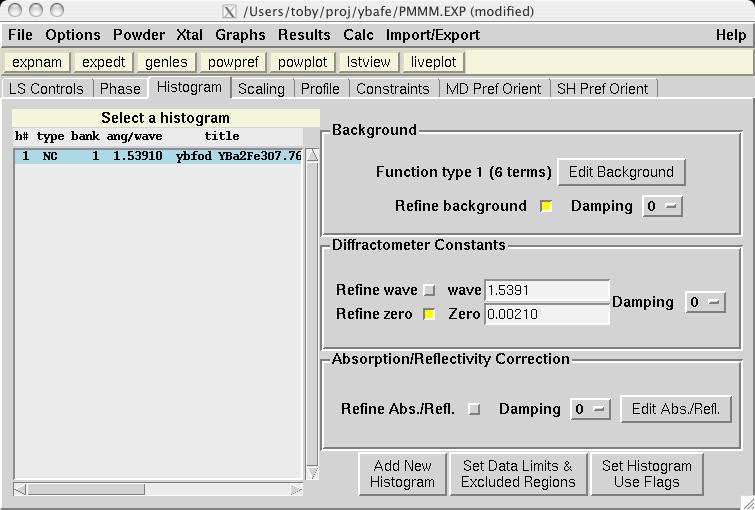

Finally, confirm that the "Refine background" option is selected so that
the background will be fit
(screen image).

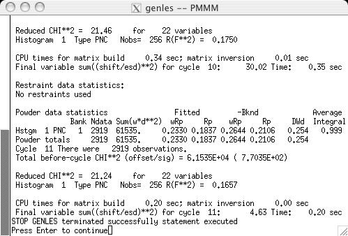

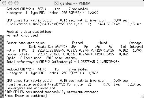

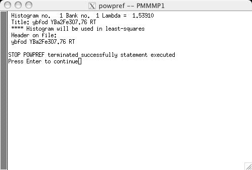

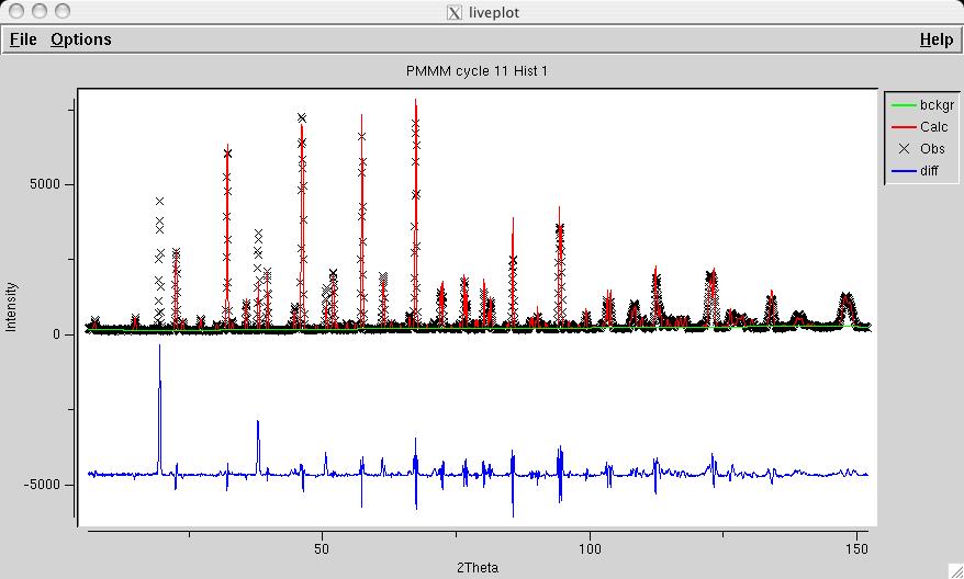

Start Initial Fit of Experimental Parameters

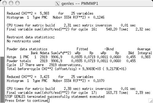

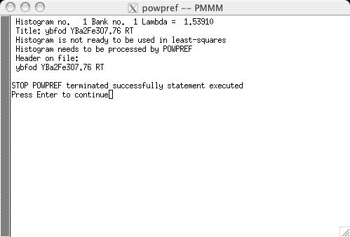

The fit can now be started, by pressing the "powpref"
(screen image)
and "genles" buttons
(screen image).

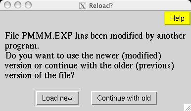

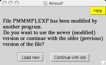

Note that pressing each button starts a program in another
window and then (unless the default settings have been changed) after
each run has been completed, the extra window is closed and the "Load
New" button is pressed on the Reload screen
(screen image).

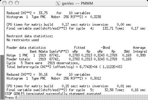

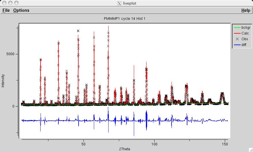

Note that after the two cycles
of refinement, the chi2 value drops to approximately 44.

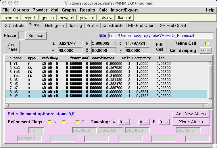

At this point the unit cell is refined, by selecting the the "Refine Cell" option on the Phase panel (screen image). Press the "genles" button and note that the fit improves to a chi2 value of approximately 30 (screen image). The two-theta zero is now refined using the "Refine zero" control on the Histogram panel (screen image). Press the "genles" button and note that the fit improves to a chi2 value of approximately 28.
Start Initial Fit of Structural Parameters
At this point an initial fit of the structure is performed (although some
researchers might delay this until the magnetic modeling is included). While
under normal conditions, it would be wise to add refinement of variables
over the course of several refinement runs, in this case the model is
quite stable with respect to refinement and this can
be done in a single run. Before starting the refinement, however,
Uiso values for like element
types are grouped together to reduce the number of parameters.

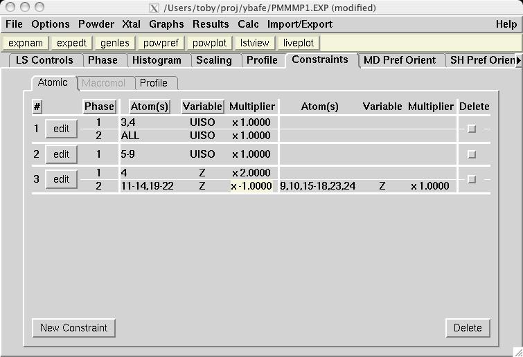

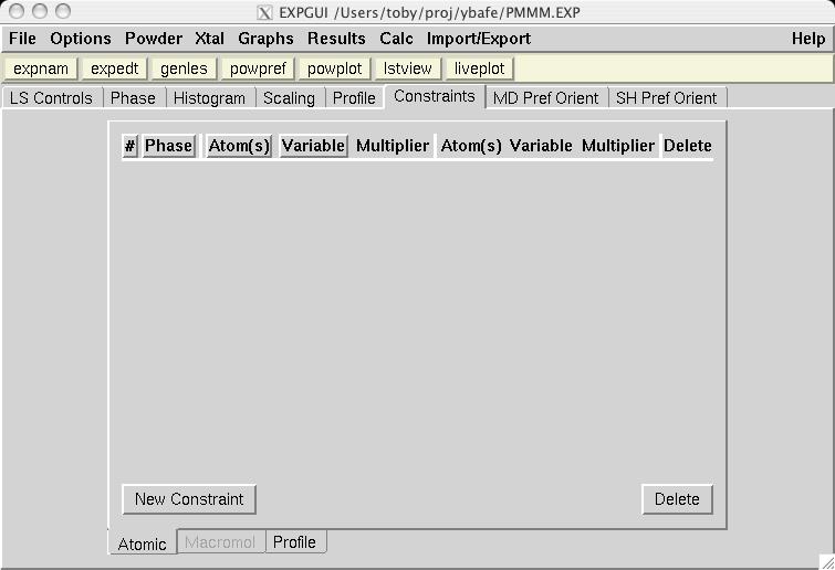

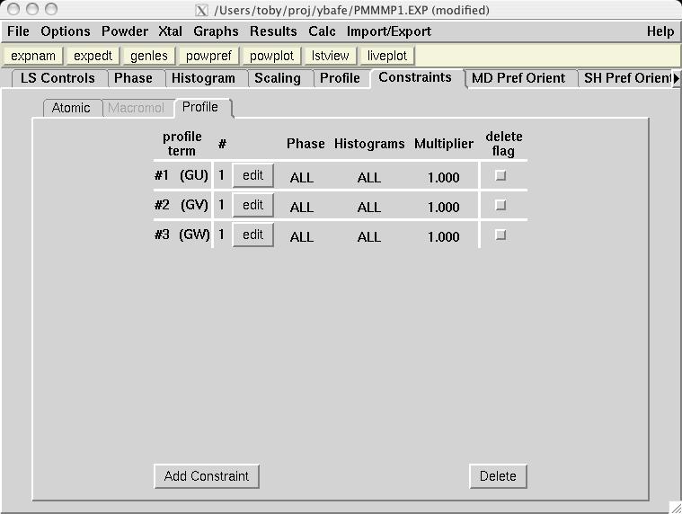

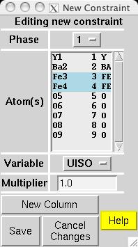

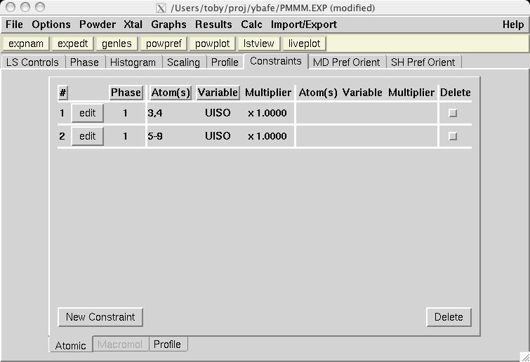

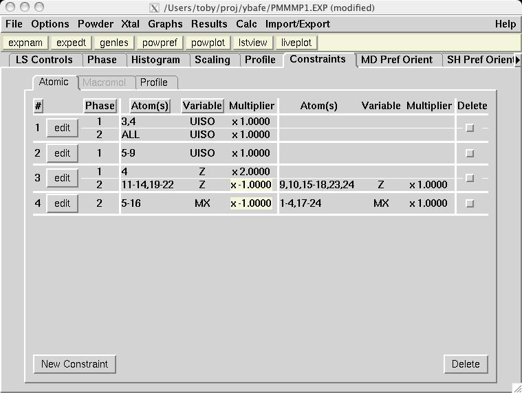

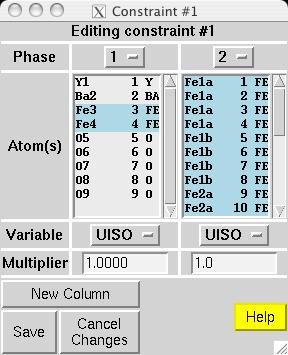

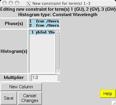

This is done with the Constraints panel
(screen image).

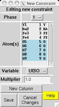

To set up the constraint on the Fe atoms,
Press on the "New Constraints" button, then select them by dragging over
them with the mouse and select UISO in the Variable menu button
(screen image)
and press "Save".
Repeat this with the O atoms,
Press on the "New Constraints" buttton by dragging over those atoms
with the mouse; then select UISO in the Variable menu button
(screen image)
and press "Save".
The Constraints panel will then list the two constraints
(screen image).

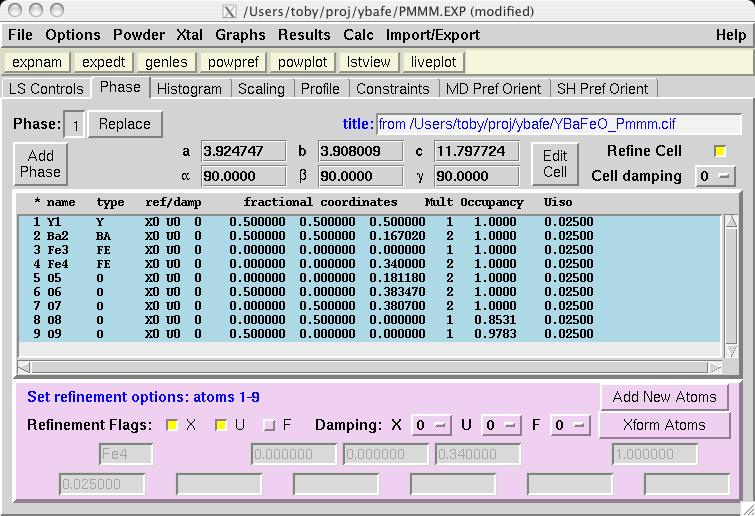

To refine the nuclear model, select all atoms on the phase panel (the right mouse button will do this) and click on the X and U "Refinement Flag" buttons (screen image) so that all atom positions can be optimized in addition to 4 Uiso values (1 for the Fe atoms, 1 for the O atoms, 1 for the Y atom and 1 for the Ba atom). Note that the atom positions will only be optimized as far as allowed by symmetry, so the Ba position at (1/2,1/2,1/2) will not actually change. Then set the F (fractional occupancy) flag for O8 and O9 only (screen image). Press the "genles" button and note that the fit improves to a chi2 value of approximately 21 (screen image). A view of the fit in LIVEPLOT shows the profile terms need some refinement (which will be done later) and there is significant missing intensity for several low angle reflections (screen image) -- not surprising, since magnetic scattering is not included.

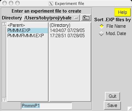

To do this, use the "Save As" option in the EXPGUI "File" menu item.
This opens an experiment file window, where the new name to be used
is specified
(screen image).
The name PmmmP1 was selected here, since the nuclear structure will be
modeled in space group Pmmm and the magnetic structure in
P1 and a new experiment file, named PMMMP1.EXP is created.

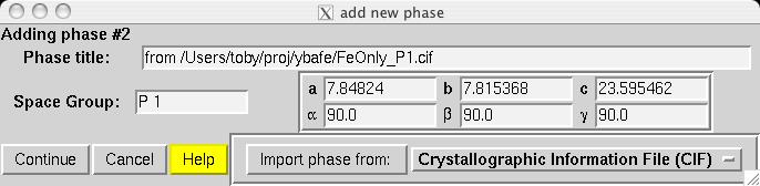

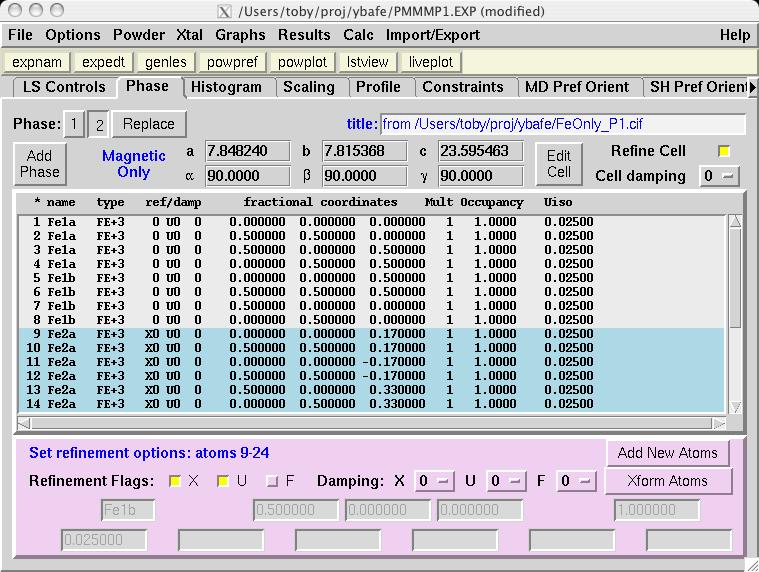

- First, the phase is loaded by clicking on the "Add Phase" button on the
Phase panel. To input the information from the CIF,
FeOnly_P1.cifcan be selected. (screen image); click on "Open" after the file is selected. - In the add new phase window,
change the a, b & c parameters to be twice those of the
first phase, then click on "Continue" on the add new phase
(screen image).
Then press "Continue" on the Check symmetry window.

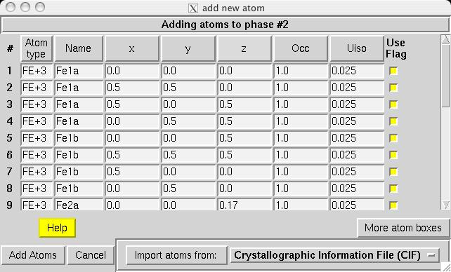

This causes the Adding atoms... window to be displayed.
(screen image).
Press the "Add Atoms" button on this window
to add the phase.

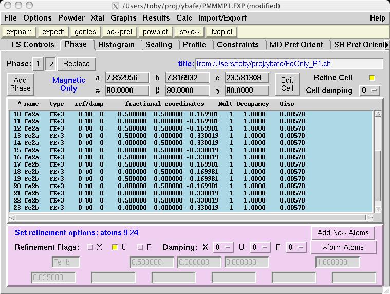

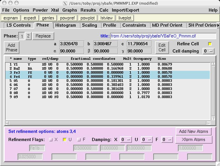

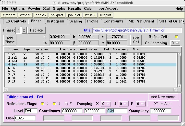

Rather than change all 24 atoms in this new phase to match the two Fe atoms in phase 1, it is easier to edit the two atoms in Phase 1. In the Phase panel, select Phase 1, then
- Change Uiso for both Fe atoms to 0.025, to match the newly entered atoms
- Change the zcoordinate of the second Fe atom to 0.34 to match the coordinates for the Fe2a and Fe2b atoms in phase 2 (screen image)

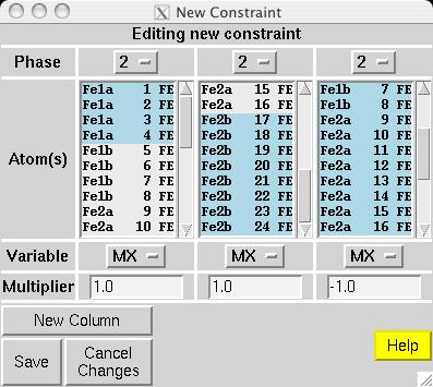

To add a separate magnetic phase, the phase will be added as a standard (nuclear scattering-only) phase using EXPGUI, then EXPEDT is used to change a flag so that it contribributes only as a magnetic scatterer. A large number of constraints on atomic, unit cell and profile parameters are needed. Some of these values can be set from EXPGUI, but others must be set from EXPEDT.
The magnetic phase is described using:
| Label | x | y | z | Moment, mx |
| Fe1a1 | 0.0 | 0.0 | 0.0 | 3.5 |
| Fe1a2 | 0.5 | 0.5 | 0.0 | 3.5 |
| Fe1a3 | 0.5 | 0.0 | 0.5 | 3.5 |
| Fe1a4 | 0.0 | 0.5 | 0.5 | 3.5 |
| Fe1b1 | 0.0 | 0.0 | 0.5 | -3.5 |
| Fe1b2 | 0.5 | 0.5 | 0.5 | -3.5 |
| Fe1b3 | 0.5 | 0.0 | 0.0 | -3.5 |
| Fe1b4 | 0.0 | 0.5 | 0.0 | -3.5 |
| Fe2a1 | 0.0 | 0.0 | 0.17 | -3.5 |
| Fe2a2 | 0.5 | 0.5 | 0.17 | -3.5 |
| Fe2a3 | 0.0 | 0.0 | -0.17 | -3.5 |
| Fe2a4 | 0.5 | 0.5 | -0.17 | -3.5 |
| Fe2a5 | 0.5 | 0.0 | 0.33 | -3.5 |
| Fe2a6 | 0.0 | 0.5 | 0.33 | -3.5 |
| Fe2a7 | 0.0 | 0.5 | -0.33 | -3.5 |
| Fe2a8 | 0.5 | 0.0 | -0.33 | -3.5 |
| Fe2b1 | 0.5 | 0.0 | 0.17 | 3.5 |
| Fe2b2 | 0.0 | 0.5 | 0.17 | 3.5 |
| Fe2b3 | 0.5 | 0.0 | -0.17 | 3.5 |
| Fe2b4 | 0.0 | 0.5 | -0.17 | 3.5 |
| Fe2b5 | 0.0 | 0.0 | 0.33 | 3.5 |
| Fe2b6 | 0.5 | 0.5 | 0.33 | 3.5 |
| Fe2b7 | 0.0 | 0.0 | -0.33 | 3.5 |
| Fe2b8 | 0.5 | 0.5 | -0.33 | 3.5 |

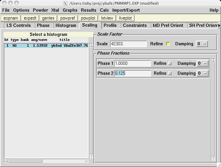

Setup Magnetic Phase
- Y
- P
- P
- m 2
- c
- x x x x
To change the flag for the second phase, the EXPEDT program is used. This can be invoked from EXPGUI, by pressing the EXPEDT button or from the Powder and Xtal menus. In EXPEDT, use the following commands:
EXPEDT prompts the user to supply a one-letter command, where inputting a blank line provides further information on what the options are (as demonstrated below). Note that commands can be combined onto the same line (usually) and can in many cases be spread over more than one line.
The input to and output from EXPEDT are shown below. User-typed input is emphasized by display in this font: Input
| Program EXPEDT Version MacOSX |
| A menu driven routine to edit .EXP files |
| Distributed on Thu Sep 30 14:58:36 2004 |
| Allen C. Larson and Robert B. Von Dreele |
| Manuel Lujan, Jr. Neutron Scattering Center, MS-H805 |
| Los Alamos National Laboratory, Los Alamos, NM 87545 |
| Copyright, 2000, The Regents of the University of California. |
The last history record is :
HSTRY 18 EXPGUI 1.74 1.42 (8 changes) -- 07/29/05 15:30:35
Is this the file you wish to use? (<?>,D,K,Q,R,Y) >Y P P
Experiment title:
Y Ba2 Fe3 O7+delta: Pmmm nuclear phase
There is phase information present
Name of phase no. 1
from /Users/toby/proj/ybafe/YBaFeO_Pmmm.cif
The phase is non-magnetic
Name of phase no. 2
from /Users/toby/proj/ybafe/FeOnly_P1.cif
Enter phase edit command(<?>,$,D,E,F,M,I,L,R,S,X) >m
Give phase number for phase type flag toggle >2
Enter phase type (<?>,A,B,C,L,X,Z) >c
The phase is magnetic.
Only magnetic peaks will be generated in the powder patterns
Enter phase type (<?>,A,B,C,L,X,Z) >x x x x
EXPEDT data setup option (<?>,D,F,K,L,P,R,S,X) >
One more X command could now be entered to exit EXPEDT, but since the next step will continue in EXPEDT, this is not necessary.

Phase No. 1; Phase has 9 atoms; Title: from /Users/toby/proj/ybafe/YBaFeO_

SER TYPE X Y Z FRAC NAME UISO CODE STSYM MULT FXU
MX MY MZ MCODE
1 FE+3 0.00000 0.00000 0.00000 1.00000 Fe1a 0.02500 I 1 1 000
3.500 0.000 0.000
2 FE+3 0.50000 0.50000 0.00000 1.00000 Fe1a 0.02500 I 1 1 000
3.500 0.000 0.000
3 FE+3 0.50000 0.00000 0.50000 1.00000 Fe1a 0.02500 I 1 1 000
3.500 0.000 0.000
4 FE+3 0.00000 0.50000 0.50000 1.00000 Fe1a 0.02500 I 1 1 000
3.500 0.000 0.000
5 FE+3 0.00000 0.00000 0.50000 1.00000 Fe1b 0.02500 I 1 1 000
-3.500 0.000 0.000
6 FE+3 0.50000 0.50000 0.50000 1.00000 Fe1b 0.02500 I 1 1 000
-3.500 0.000 0.000
7 FE+3 0.50000 0.00000 0.00000 1.00000 Fe1b 0.02500 I 1 1 000
-3.500 0.000 0.000
8 FE+3 0.00000 0.50000 0.00000 1.00000 Fe1b 0.02500 I 1 1 000
-3.500 0.000 0.000
9 FE+3 0.00000 0.00000 0.17000 1.00000 Fe2a 0.02500 I 1 1 000
-3.500 0.000 0.000
10 FE+3 0.50000 0.50000 0.17000 1.00000 Fe2a 0.02500 I 1 1 000
-3.500 0.000 0.000
Enter to continue or "Q" to quit >
MX MY MZ MCODE
11 FE+3 0.00000 0.00000-0.17000 1.00000 Fe2a 0.02500 I 1 1 000
-3.500 0.000 0.000
12 FE+3 0.50000 0.50000-0.17000 1.00000 Fe2a 0.02500 I 1 1 000
-3.500 0.000 0.000
13 FE+3 0.50000 0.00000 0.33000 1.00000 Fe2a 0.02500 I 1 1 000
-3.500 0.000 0.000
14 FE+3 0.00000 0.50000 0.33000 1.00000 Fe2a 0.02500 I 1 1 000
-3.500 0.000 0.000
15 FE+3 0.00000 0.50000-0.33000 1.00000 Fe2a 0.02500 I 1 1 000
-3.500 0.000 0.000
16 FE+3 0.50000 0.00000-0.33000 1.00000 Fe2a 0.02500 I 1 1 000
-3.500 0.000 0.000
17 FE+3 0.50000 0.00000 0.17000 1.00000 Fe2b 0.02500 I 1 1 000
3.500 0.000 0.000
18 FE+3 0.00000 0.50000 0.17000 1.00000 Fe2b 0.02500 I 1 1 000
3.500 0.000 0.000
19 FE+3 0.50000 0.00000-0.17000 1.00000 Fe2b 0.02500 I 1 1 000
3.500 0.000 0.000
20 FE+3 0.00000 0.50000-0.17000 1.00000 Fe2b 0.02500 I 1 1 000
3.500 0.000 0.000
MX MY MZ MCODE
21 FE+3 0.00000 0.00000 0.33000 1.00000 Fe2b 0.02500 I 1 1 000
3.500 0.000 0.000
22 FE+3 0.50000 0.50000 0.33000 1.00000 Fe2b 0.02500 I 1 1 000
3.500 0.000 0.000
23 FE+3 0.00000 0.00000-0.33000 1.00000 Fe2b 0.02500 I 1 1 000
3.500 0.000 0.000
24 FE+3 0.50000 0.50000-0.33000 1.00000 Fe2b 0.02500 I 1 1 000
3.500 0.000 0.000

After the EXPEDT window is closed since EXPEDT has changed the experiment file, (unless the Autoload EXP option is set) there is a prompt to load the information from this changed file: press the "Load new" button to continue (screen image).
Setup Atomic Constraints

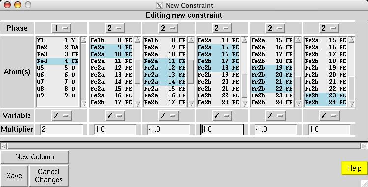

The Fe2a & Fe2b atoms in the magnetic phase should move in concert with the Fe4 atom in the nuclear phase, where the shift on the atoms in phase 2 will be +/-50% of the shift on Fe4 in phase 1. The atoms at z=0.17 and z=-0.33 will have shifts in the same direction as the shift on Fe4 and and the shift on Fe4b will be the atoms at z=-0.17 and z=0.33 will have shifts in the opposite direction. Create a constrint in the Constraints menu, by pressing the "New Constraint" button to open the Edit Constraint window. Press the "New Column" button four times create four additional (five total) constraint subwindows. Select Phase 1, Fe4, variable Z and multiplier 2.0 in one column, Select a multiplier of 1.0 for Z of atoms 9-10, 15-18 and 23-24 and a multiplier of -1.0 for Z of atoms 11-14 and 19-22. (screen image). Then press the "Save" button to enter the new constraint.
Likewise, the constraint on the Uiso for the Fe atoms is expanded to include all the Fe atoms in the second phase. This is done by clicking on the first "edit" button to amend the first constraint. On the Editing Constraint #1 window, press the "New Column" button, select Phase 2 in the new column, select all atoms; the Variable selection defaults to Uiso and the Multiplier value defaults to 1.0 (screen image). Then press the "Save" button to enter the modified constraint (screen image).

The commands above constrain the z values of the phase 2 atoms, but it should be noted that the x and y locations of these atoms are not constrained by the P1 symmetry. However, these coordinates should not be refined, so that the positions match that of Fe3 & Fe4. For the Fe1a and Fe1b atoms, this is easy. Simply do not set the X flag and these positions will not change. For the remaining atoms, the X flag must be set so that the z values of the phase 2 atoms, can vary in concert with atom Fe4 in phase 1. This is done in EXPEDT using the following sequence of commands:

Constrain Phase Fractions
GSAS scale factors are proportional to the number of scatters present in the unit cell. Since the unit cell of the magnetic phase is eight times larger than that of the nuclear phase, the scattering from this phase will be over counted. To prevent this (so that magnetic moments are scaled properly with respect to the nuclear scattering), the phase fraction of the second phase is lowered by the ratio of the unit cell volumes (1/8). This is done by changing the Phase Fraction for Phase 2 on the Scaling panel (screen image). Make sure that the scale factor is refined, but not either of the phase fractions.
Phase 2 Refinement Flags
- Click on the "Refine Cell" checkbutton.
Also, turn on the
X flags for Fe atoms 9-24, so that the z coordinates
refine, and turn on the U flag for all atoms.
(screen image).
Note that the first two Fe atoms in the magnetic phase will not change position regardless of the X flag, as they are on special positions with no degrees of freedom.
Constraints have been established on the unit cell and the atomic parameters of phase 2. It is important to set the refinement flag and damping values to be the same for constrained parameters. Since unit cell paremeters, Uiso values and Fe4 z are refined in phase 1, the same must be done in phase 2. On the phase panel, select phase 2, noting that EXPGUI now shows that the phase is magnetic-only directly below the phase selection buttons.
Refine with Magnetic Phase
Since a new phase has been added to the refinement, it is necessary to run POWPREF (screen image). and then GENLES (screen image). The fit improves from the previous chi2 value of approximately 21 to a new value of approximately 15, as the low-angle magnetic lines are now computed with more intensity, as can now be seen in LIVEPLOT (screen image).

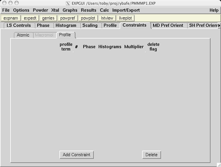

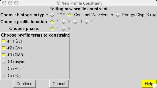

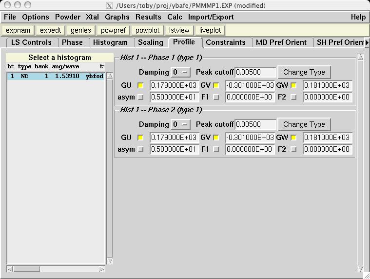

Constrain and Refine Profile Constraints
From the previous LIVEPLOT result, it is clear that the profile is a major source of differences between the observed and computed diffraction data. While it is possible to have different ordering ranges for the nuclear and magnetic ordering, in most cases, it is best to have the same parameters, for both the nuclear and magnetic phases.

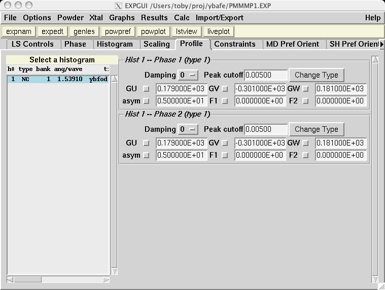

A quick check of the Profile panel shows that the profile termes are the same for both phases because they are still at their default values, having not been refined. (screen image). To constrain the profile terms to refine to be the same, select the Constraints panel and the click on the lower Profile tab and then press the "Add Constraint" button (screen image). This will open the New Profile Constraint window (screen image). Select GU, GV & GW to be constrained (none of the other terms need to be refined); then press the "Continue" button. In the next window, select both phases in the top part of the window and press the "Save" button (screen image). This generates the constraints, which show up on the Constraint panel (screen image).
Select the check buttons for GU, GV & GW in both phases (screen image) and then start GENLES (screen image). The fit improves from the previous chi2 value of approximately 15 to a new value of approximately 3.4. Running POWPREF and then GENLES again causes chi2 to drop from 3.4 to 2.6 just due to the expansion of the peak shape range from POWPREF. Subsequent refinement cycles improves chi2 slightly, to 2.45 (screen image).
Constrain & Refine Magnetic Moment
In most magnetic refinements, one wishes to refine magnetic moments.
It should be noted that the Fe1a and Fe1b atoms are symmetry related,
as is the case for Fe2a and Fe2b.
One could consider treating the two Fe1 atoms as having
different moments from the two Fe2 atoms, but this makes little
chemical sense, since there is no reason to expect either site to
have an accumulation of off-valence Fe atoms. Further, due to the
pseudo-symmmetry of the cell, there are few reflections that distinguish
the two non-equivalent Fe scatterers. Thus, it is best
to treat all Fe atoms as having a single magnetic moment. EXPGUI
can be used to set up constraints on the magnetic moments,
by creating a new atom constraint on the Constraints panel, where a
shift multiplier of 1.0 is applied to MX for atoms in phase 2
with positive MX value (atoms 1-4, 17-24)
and a shift multiplier of -1.0 is applied to MX for atoms in phase 2
with negative MX value (atoms 5-16)
(screen image).Press the "Save" button and the constraint appears
(screen image).
