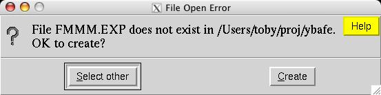

The first step in the refinement is to start a new refinement by creating a
new experiment file. Start EXPGUI and enter a new file name
then click on the "Create" button to then create a new, empty, experiment file

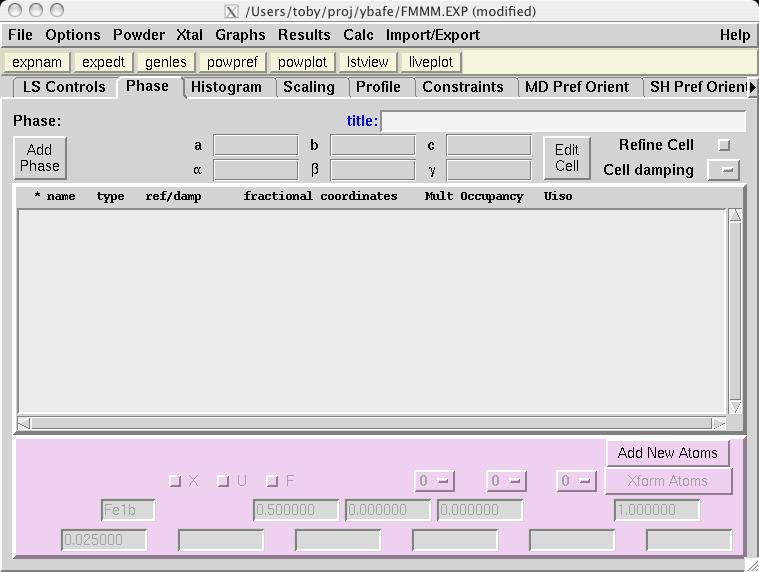

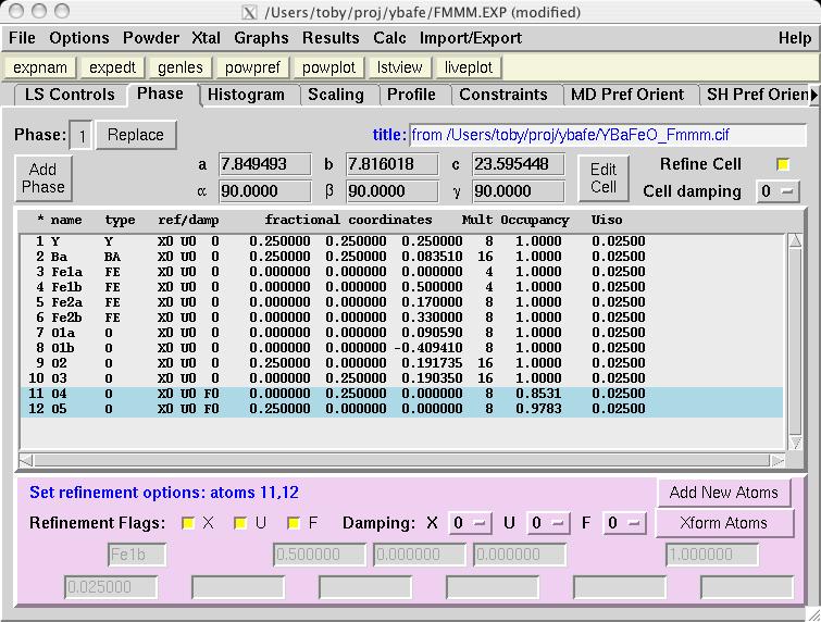

Go to the Phase panel
(screen image)

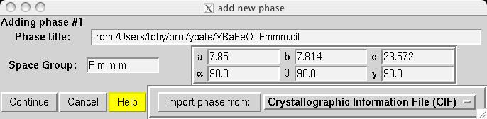

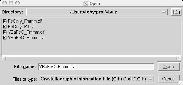

and press the "Add Phase" button. To input the information from the CIF,
click on the "PowderCell .CEL file" menu button to bring up a menu of choices
(screen image)
and select "Crystallographic Information File (CIF)"
which brings up a window where the file YBaFeO_Fmmm.cif can be selected.
(screen image);
click on "Open" after the file is
selected.

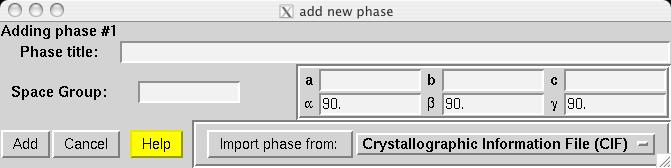

Click on "Continue" on the add new phase
(screen image)

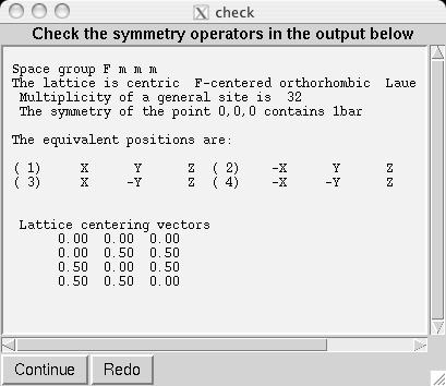

and on the Check symmetry windows
(screen image)

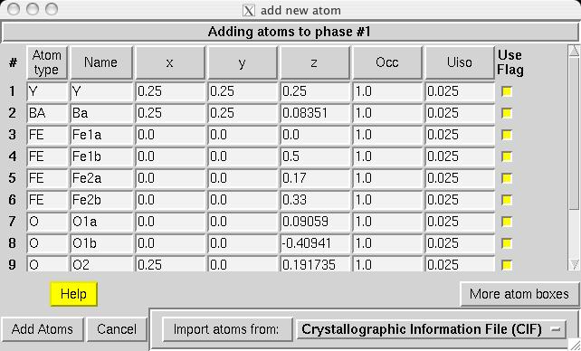

and then "Add Atoms" on the Adding atoms... window
(screen image)

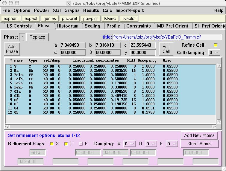

and the phase has been added, just like that.
Finally, make sure the "Refine Cell" option is not selected,
(screen image)
so that the unit cell parameters
will be refined until later, after the background and scale factor
are first brought into the right range.

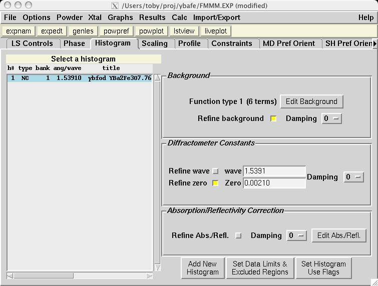

Input Diffraction Data

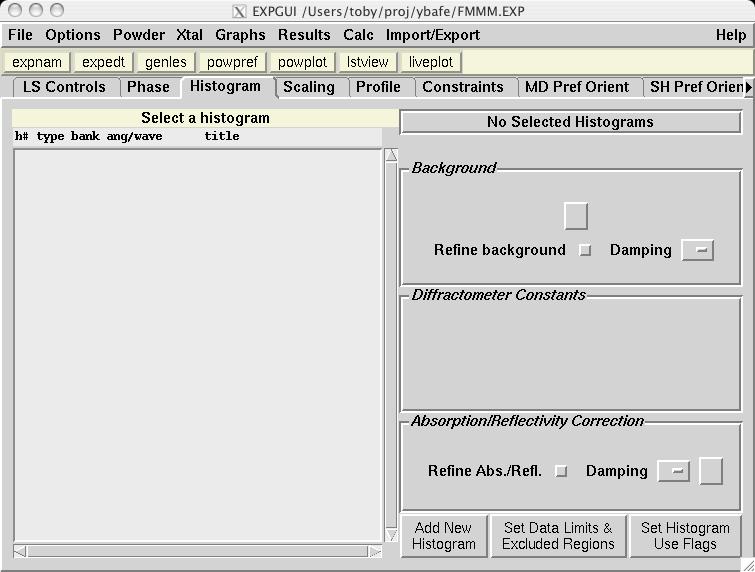

The second step in almost every GSAS refinement is to input diffraction data
(or select data parameters in a simulation). This is done from the Histogram
panel
(screen image).

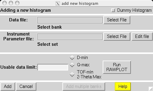

Click on the "Add New Histogram" button
which brings up the add new histogram window
(screen image).

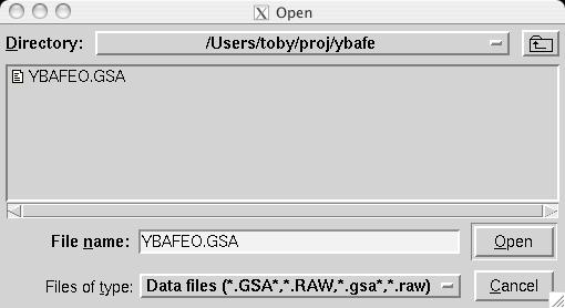

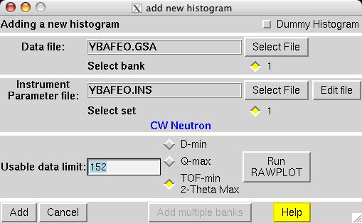

Press the Select file to select the appropriate GSAS data file
in the Open window
(screen image);
press the open button
and the file names for the both the data file and the instrument parameter files
are loaded (you might see messages about file conversions if the download
process has stripped non-printing characters needed from the files.). Finally,
change the data range to utilize a maximum two-theta of 152 degrees
on the add new histogram window, which
eliminates the last very wide peak from use in the refinement (the fit
would also progress well were this peak included)
(screen image).
Press "Add" on this window and the
diffraction data are now included in the refinement

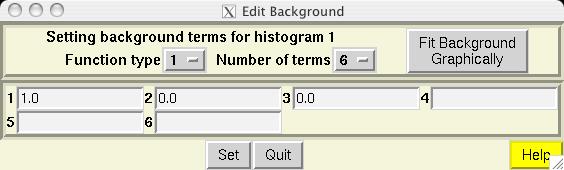

Finally, change the background function to type 1 with 6 terms by pressing the
"Edit Background" button (this is the authors' preference -- but other
settings could be selected.)
(screen image).
Finally, confirm that the "Refine background" option is selected so that
the background will be fit
(screen image).

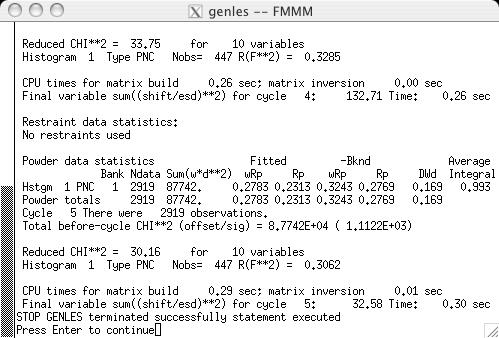

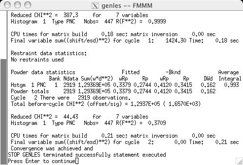

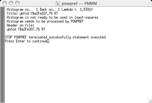

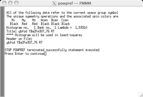

Start Initial Fit of Experimental Parameters
The fit can now be started, by pressing the "powpref"
(screen image)
and "genles" buttons
(screen image).

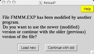

Note that pressing each button starts a program in another
window and then (unless the default settings have been changed) after
each run has been completed, the extra window is closed and the "Load
New" button is pressed on the Reload screen
(screen image).

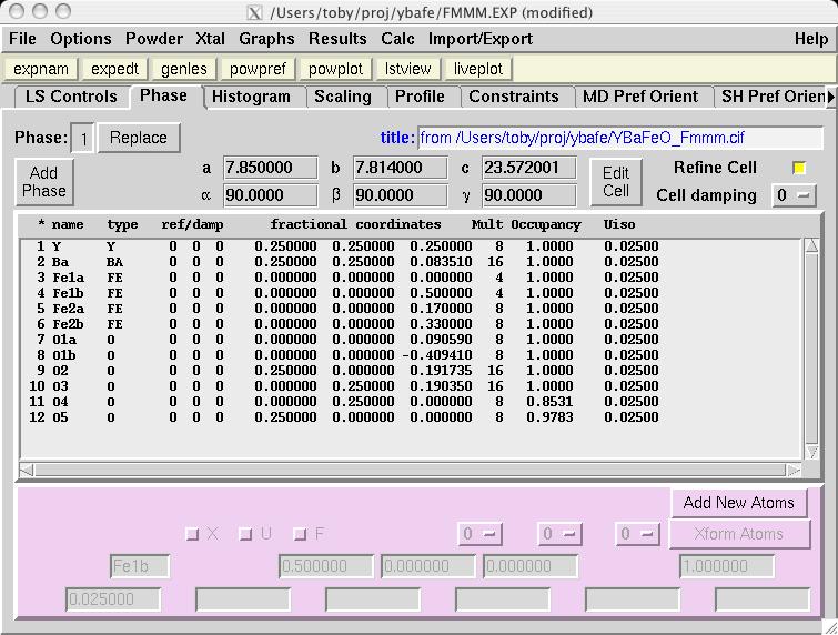

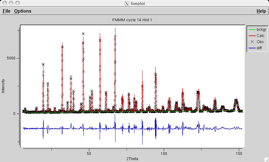

Note that after the two cycles
of refinement, the chi2 value drops to approximately 44.
At this point the unit cell is refined, by selecting the the "Refine Cell" option on the Phase panel (screen image). Press the "genles" button and note that the fit improves to a chi2 value of approximately 30 (screen image). The two-theta zero is now refined using the "Refine zero" control on the Histogram panel (screen image). Press the "genles" button and note that the fit improves to a chi2 value of approximately 28 (screen image).

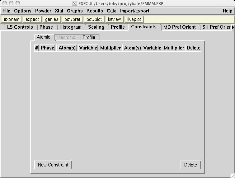

Constrain Structural Parameters

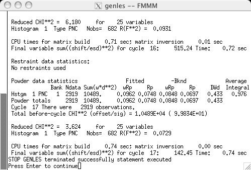

At this point an initial fit of the structure is performed (although some
researchers might delay this until the magnetic modeling is included). While
under normal conditions, it would be wise to add refinement of variables
over the course of several refinement runs, in this case the model is
quite stable with respect to refinement and this can
be done in a single run. Before starting the refinement, however,

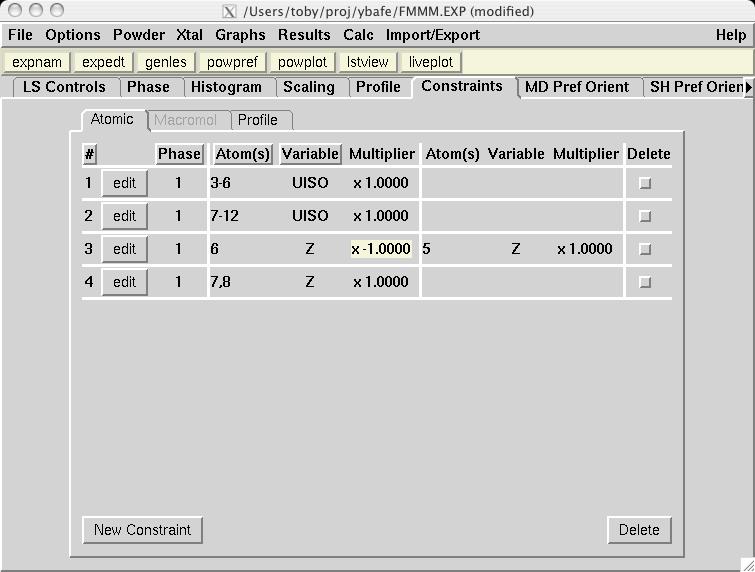

Uiso values for like element
types are grouped together to reduce the number of parameters.

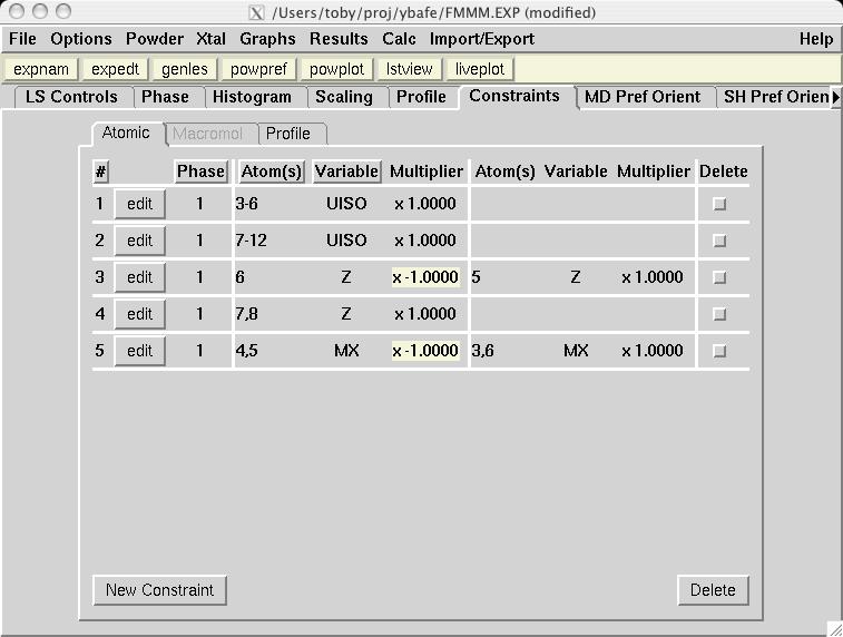

This is done with the Constraints panel
(screen image).

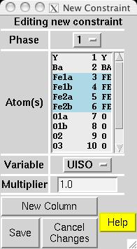

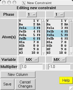

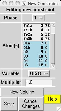

- To set up the constraint on the Fe atoms, Press on the "New Constraints" button, then select them by dragging over them with the mouse and select UISO in the Variable menu button (screen image) and press "Save".
- Repeat this with the O atoms, Press on the "New Constraints" buttton by dragging over those atoms with the mouse; then select UISO in the Variable menu button (screen image) and press "Save".

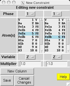

- Now create a constraint to link the positions of Fe2a and Fe2b, by pressing on the "New Constraints" button, then in the new window press the "New Column" button. In one column, select atom Fe2a, variable Z and multiplier 1.0 while in the column, select atom Fe2b, variable Z and multiplier -1.0 (screen image).

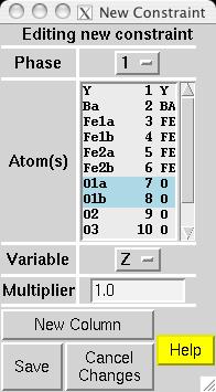

- For O1a and O1b, the z coordinates must move in the same
direction (since they are generated as z/2 and -0.5+z/2). This is
done by pressing on the "New Constraints" button, then
selecting atom O1a and O1b, variable Z and multiplier 1.0
(screen image).
The Constraints panel will then list the four constraints
(screen image).

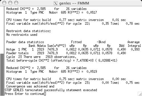

Start Initial Fit of Structural Parameters
To refine the nuclear model, select all atoms on the phase panel (the right mouse button will do this) and click on the X and U "Refinement Flag" buttons (screen image) so that all atom positions can be optimized in addition to 4 Uiso values (1 for the Fe atoms, 1 for the O atoms, 1 for the Y atom and 1 for the Ba atom). Then set the F (fractional occupancy) flag for O4 and O5 only (screen image). Press the "genles" button and note that the fit improves to a chi2 value of approximately 21 (screen image). A view of the fit in LIVEPLOT shows the profile terms need some refinement (which will be done later) and there is significant missing intensity for several low angle reflections (screen image) -- not surprising, since magnetic scattering is not included.

After the EXPEDT window is closed since EXPEDT has changed the experiment file, (unless the Autoload EXP option is set) there is a prompt to load the information from this changed file: press the "Load new" button to continue.

Since the phase type has been changed, it is necessary to run POWPREF (screen image). and then GENLES (screen image). The fit improves from the previous chi2 value of approximately 21 to a new value of approximately 15, as the low-angle magnetic lines are now computed with more intensity, as can now be seen in LIVEPLOT (screen image).

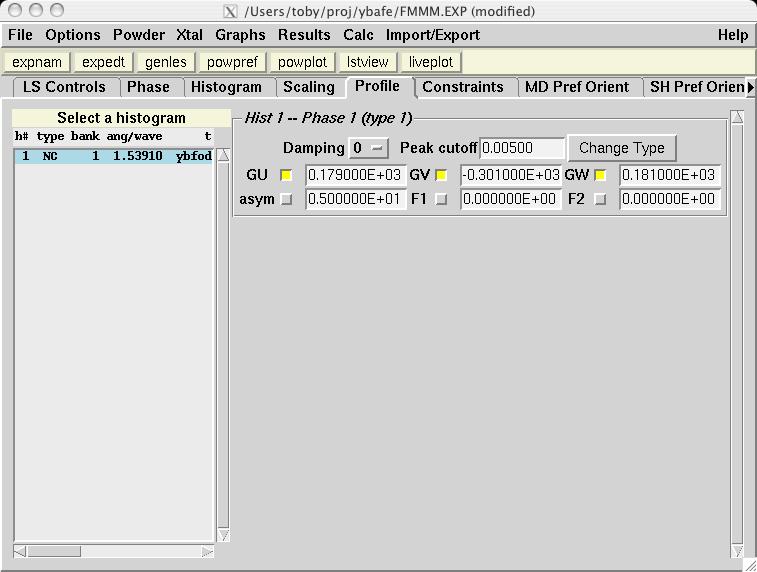

Refine Profile Constraints
From the previous LIVEPLOT result, it is clear that the profile is a major source of differences between the observed and computed diffraction data. While it is possible to have different ordering ranges for the nuclear and magnetic ordering, this cannot be incorporated into a refinement with a single nuclear and magnetic phase.
Select the check buttons for GU, GV & GW on the Profile panel (screen image) and then start GENLES (screen image). The fit improves from the previous chi2 value of approximately 15 to a new value of approximately 3.4. Running POWPREF and then GENLES again causes chi2 to drop from 3.4 to 2.8 just due to the expansion of the peak shape range from POWPREF. Subsequent refinement cycles improves chi2 slightly, to 2.6.
Constrain & Refine Magnetic Moment
In most magnetic refinements, one wishes to refine magnetic moments.
It should be noted that the Fe1a and Fe1b atoms are symmetry related,
as is the case for Fe2a and Fe2b.
One could consider treating the two Fe1 atoms as having
different moments from the two Fe2 atoms, but this makes little
chemical sense, since there is no reason to expect either site to
have an accumulation of off-valence Fe atoms. Further, due to the
pseudo-symmmetry of the cell, there are few reflections that distinguish
the two non-equivalent Fe scatterers. Thus, it is best
to treat all Fe atoms as having a single magnetic moment. EXPGUI
can be used to set up constraints on the magnetic moments,
by creating a new atom constraint on the Constraints panel, where a
shift multiplier of 1.0 is applied to MX of atoms 3 & 6
and a shift multiplier of -1.0 is applied to MX of atoms 4 & 5
(screen image).
Press the "Save" button and the constraint appears
(screen image).

The refinement is then started with GENLES. The magnetic moments shift only slightly (as can be seen from the LSTVIEW output) and the chi2 value drops only slightly (screen image).

one might wish to obtain a slightly better fit. To do this, the number of
background parameters can be increased to the point where little improvement
is seen by adding more terms, say to around 12-14 terms. The profile can be
improved further by switching to profile type 2 or 3 and allowing the LX term
to refine.
There is a minor impurity phase, BaFeO3, that can be
included (Pm3m, a=4.0875, Ba: 0,0,0; Fe 1/2,1/2,1/2; O 1/2,1/2,0).
Note that the
phase fraction for this phase can be refined, and later the unit cell,
but the Uiso should be fixed at a reasonable level, such as the default of
0.025. With these additions, the fit can be improved to a reasonable
chi2 = 2.1 and very good R(F2) = 0.044.
